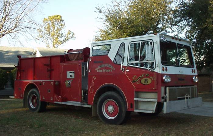

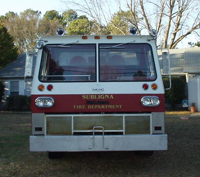

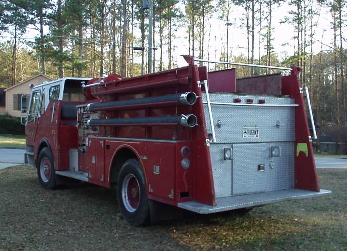

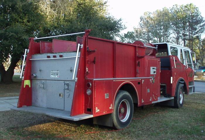

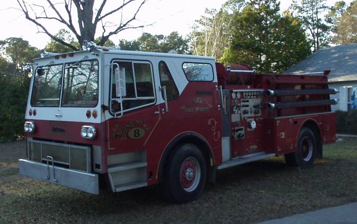

Just an update on the P-8D. It is currently sitting in the front yard with an electrical problem causing the almost brand new battery to go dead. Not yet sure if it is the alternator or the voltage regulator. I won't be able to determine which is causing the problem until I get the battery charged up and get it running again. It's 34 degrees and that doesn't help either. Anyway, here are a few shots taken today. Looks better now with the tires pumped up!

Dave, it appears that the rear axle on your truck has single rear wheels, if so that is kind of rare! I can't say I have ecer seen that on a truck that big.
tim/csff25
#28
That is true, only four tires on my rig. All Air Force P-8's were like that. The tires are wider than those found on a typical apparatus. The 4 wheel drive probably has a lot to do with it too.
#29
It also kept spare wheel and tire storage to a minimum. All AF Fire Departments are reqired to have a mounted spare tire for each type of vehicle assigned to it at the fire station. Ga Dave, I still havent talked to the guy that worked at WRAFB about the truck yet, but I will keep you posted.

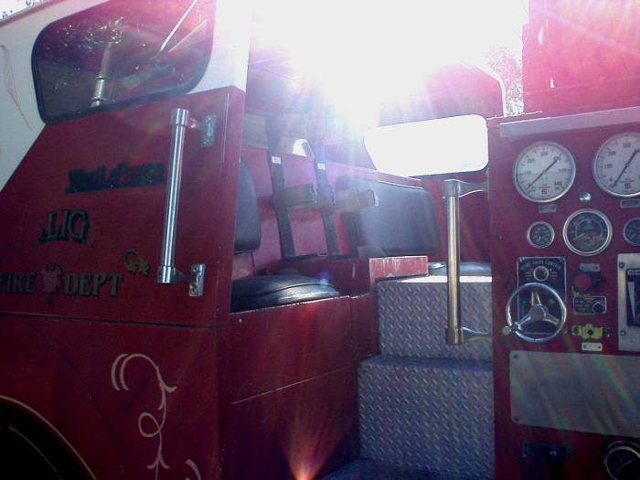

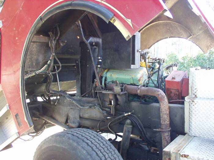

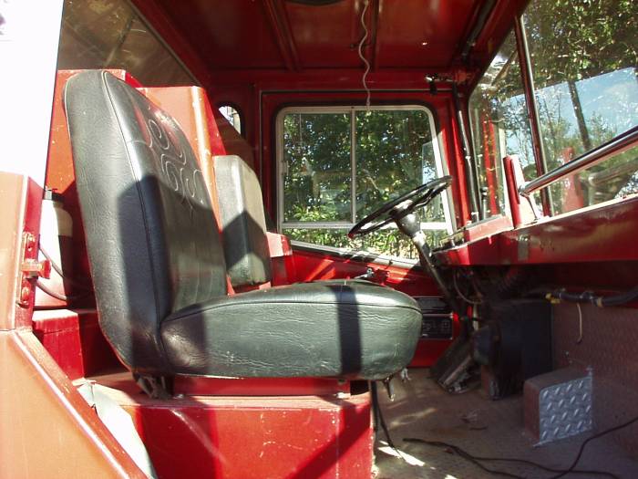

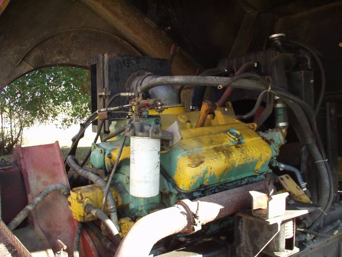

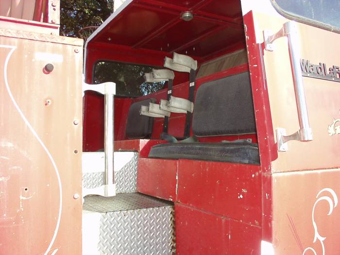

Turns out the alternator was shot, so I'll pick up the new one tomorrow. Here's a couple more shots I took this afternoon, showing both sides of the motor (minus the alternator), the jumpseat area from either side (sorry about the sun!), and the officer's side of the interior. I have been having difficulties with lowering the cab. The cab lift is a manual jack. It takes about 5 minutes to lift it up, but when it's released, it takes 30-35 minutes to come back down. This afternoon, I located a small screw in the jack that has a check valve inside. The valve was stuck, so I cleaned it and now the cab comes down in about 3 minutes!

[quote name='GA_Dave' post='78754' date='Feb 19 2007, 17:05 ']Turns out the alternator was shot, so I'll pick up the new one tomorrow. Here's a couple more shots I took this afternoon, showing both sides of the motor (minus the alternator), the jumpseat area from either side (sorry about the sun!), and the officer's side of the interior. I have been having difficulties with lowering the cab. The cab lift is a manual jack. It takes about 5 minutes to lift it up, but when it's released, it takes 30-35 minutes to come back down. This afternoon, I located a small screw in the jack that has a check valve inside. The valve was stuck, so I cleaned it and now the cab comes down in about 3 minutes![/quote]
My mechanic would love to have that kind of engine access ( tilt cab ). You are the 4th person, myself included, who have had alternator's replaced in their rigs just within the past couple of weeks.
