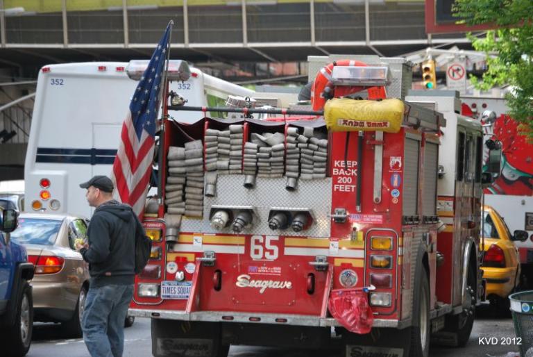

FDNY Engine 65
2002 Seagrave High pressure pumper

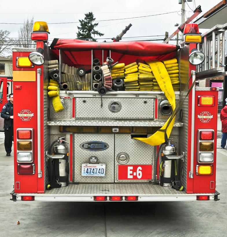

Seattle FD 2007 E\-One Cyclone II

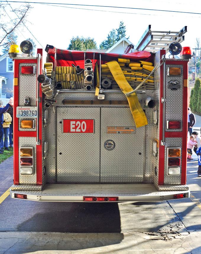

Seattle FD 2003 ALF

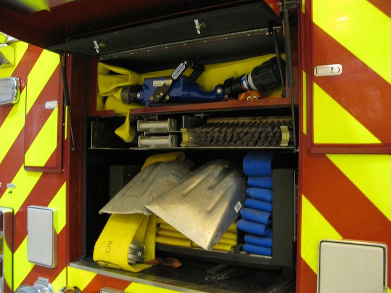

Does anyone have photos of either St Louis Smeal quints hosebeds or any Smeal for the matter as long as it's their Ergonomic Hose load?
Thanks in advance.  Karl

Thanks Rick.  We have a similar rig at our station and were looking for ideas to redo our hoseloads
