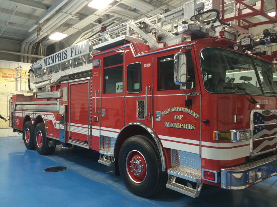

Saw on the Pierce Facebook page of the new Memphis ladder truck lettered for T-24 with all wheel steering.
There were some photos floating around Facebook on it; however, due to the dictatorship in Memphis, you will not see any pics unless someone not affiliated with MFD post. Sad times in a great department.
Photo posted by someone somewhere else...  Tisktisk
Taylor Goodman
Thanks for posting Taylor! I'm off Facebook now lol, so I don't have access to the photos anymore. I'm assuming they are trying this in lieu of a tiller. Where T24 used to be, I don't see where it would be beneficial. I remember these were big a few years back, but kinda fizzled out. Any pros or cons to the all-steer?
I wondered why I hadn't seen you post there recently.  ;-)
Although the old electronic AWS is still available from Pierce, this is the new all-mechanical AWS called the T3.  We had one of the T3 demo ladders at work for three days, and it was a hit.  I spent about two hours behind the wheel, and it was amazing.  The nice thing is that it requires VERY little training (20 minutes or so), and since it has no tail swing, the rear end will fit anywhere that the front end does.  Also, we drove across speed bumps at 35mph and barely felt them.  I predict you'll see A LOT of Pierce aerials with the T3 delivered...

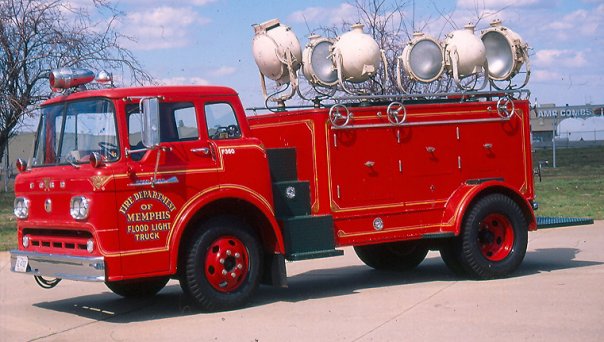

Quote:Here is the Floodlight trucks current condition. It is my understanding it is still owned by the city and was driven to its current location, parked and left to deteriorate. Sad, so very,very sad.
Photo courtesy of LarryC
[Image: FireLightTruck.jpg]
This truck was saved and being restored by Mr. Bill Adelman . Here is a link to some pics on another site.  https://www.facebook.com/groups/458135134229257/

Here is an image of the flood light truck in its better days.
Unknown Photographer.
