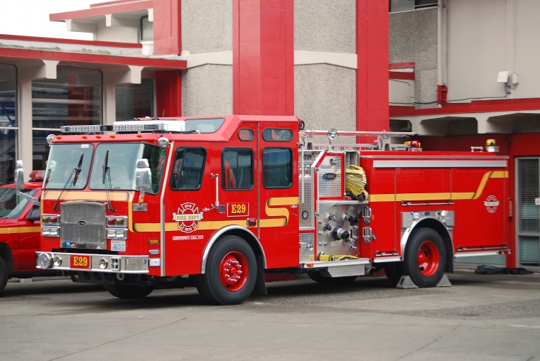

#69
SFD-West Seattle's Engine 29, 2007 E\-One

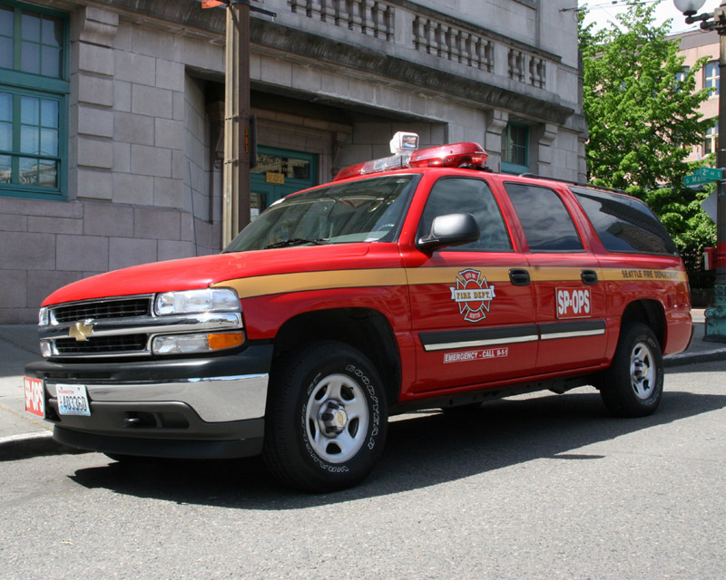

Was out in Seattle with the wife on a work trip. Got to shoot a couple rigs...
Special Ops BN Chief, outside fire HQ:
I'm down with:
IAFF, IFPA, APCO, NAED, ARRL

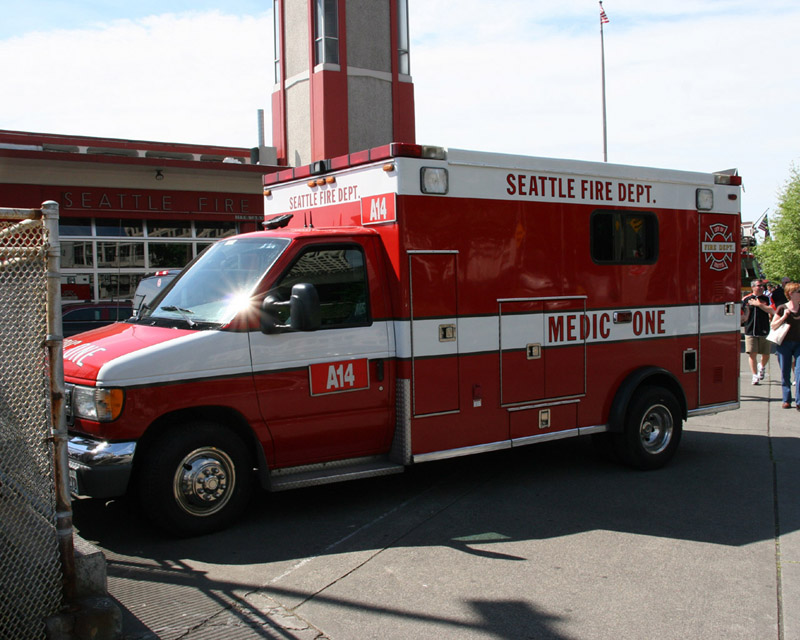

#74
Aid 14 at Station 4/5

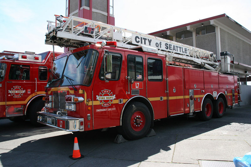

#75
Ladder 7

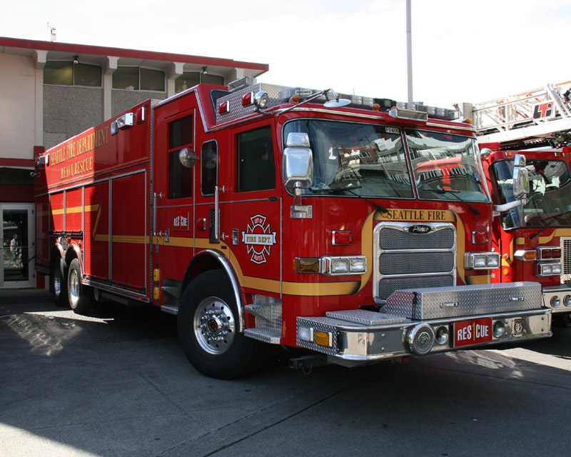

#76
Rescue 1

#77
Would love to see that Rescue in action...

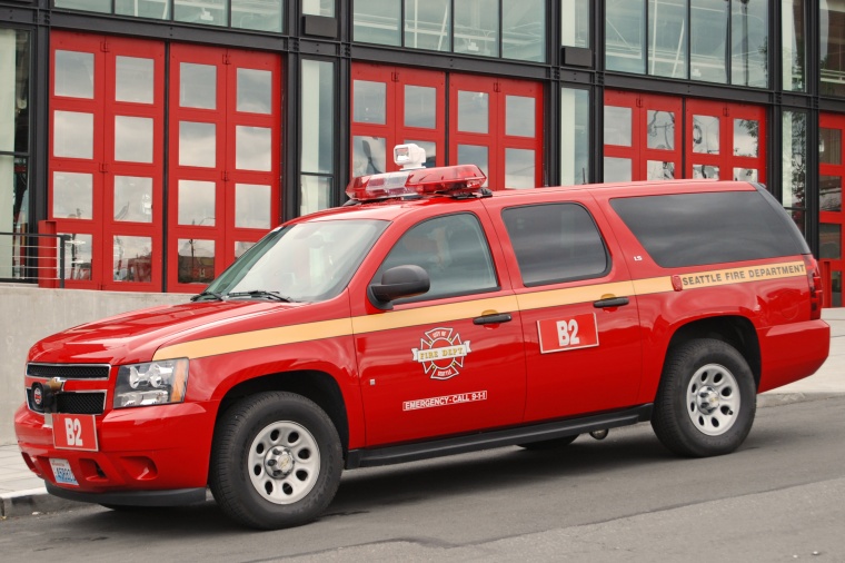

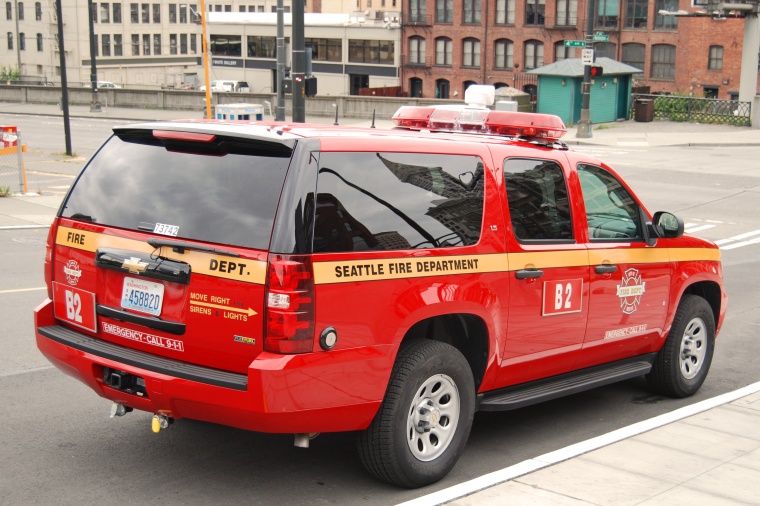

Battalion 2 has a new 2008 Chevy
#79
Rear side view.....
#80

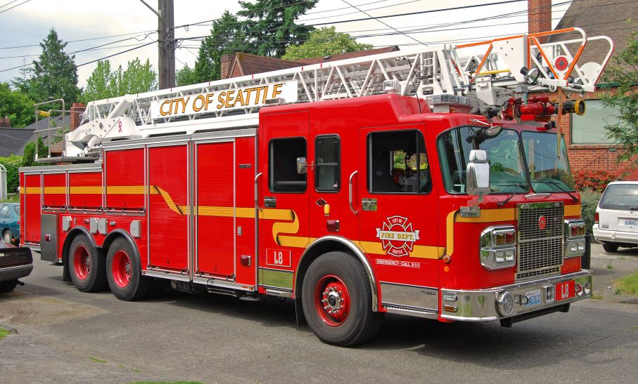

[quote name='TransverseRoad' post='186246' date='Feb 2 2008, 23:17 ']Here's Ladder 8 returning to quarters via the rear ramp, with the new Crimson rear mount. Hope to get a much better shot in the future.[/quote]
Ladder 8, 2007 Spartan, Crimson.
Correction, my error! Was delivered in 2007, but it's really a 2006 rig.
