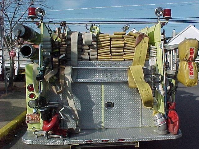

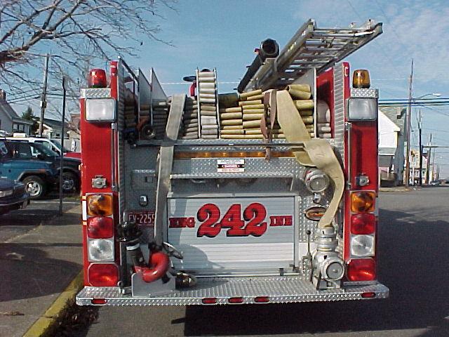

Here's two from the small combo department I vollied with back in the early '80's. West Hazleton Fire Department in northeast PA. Photo credit to Deputy Chief P. Ward, WHFD. First up Engine 241, a 1976 Seagrave.
Hose beds/loads

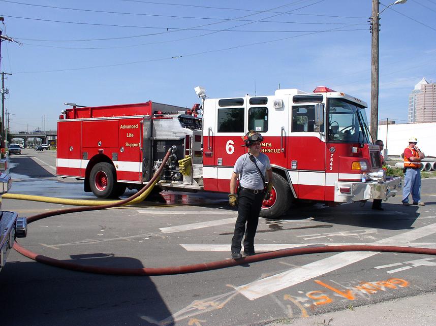

Here's an action shot of Tampa Fire Rescue Engine 6, a 1997 Quantum, one of five delivered. Most of our Quantums have two speedlay beds of 1 3/4" at 200'. Yours truly monitoring things down range while pumping a "courtyard" lay of 3'' at a natural gas leak.

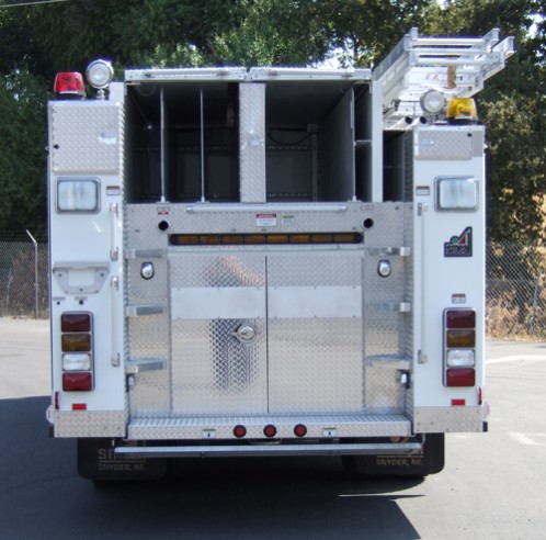

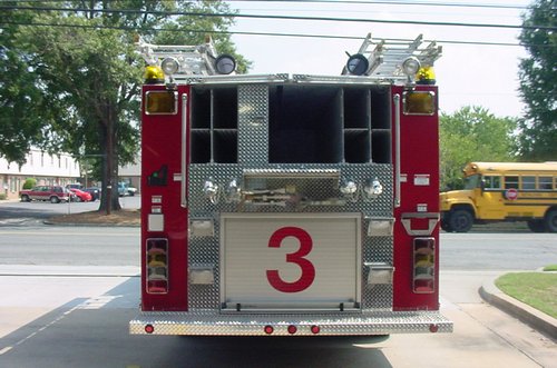

GB1 can you all pick up some ply wood? Its not pretty but it will make a pretty good divider! My VFD did it a few times.[/quote] Probably if the members buy it themselves. Right now they're worried about lay-offs later this year. Charlotte, NC 500gal tank. Would be interesting to see how they load the 'mail boxes.' Smeal website photo 750gal tank on an interface style wagon Smeal website photo
