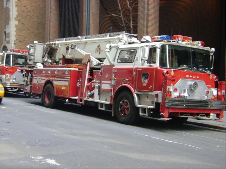

Not fdny units but i wont start a new thread Metro fire assoc tower ladder 1

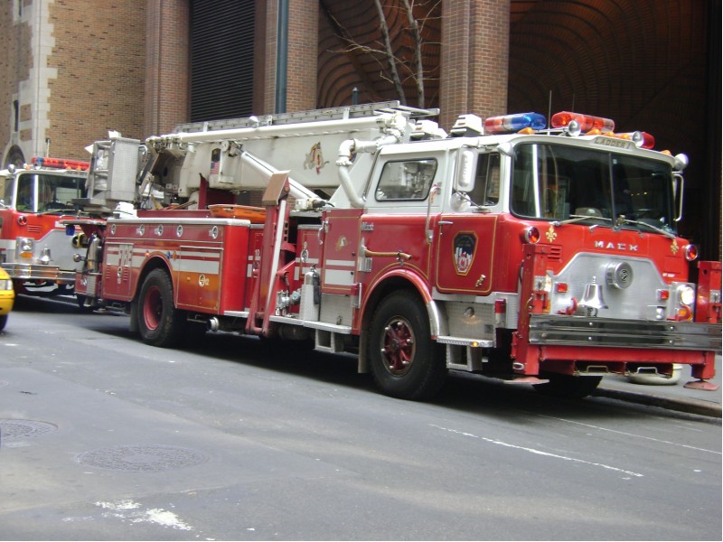

Metro fire assoc Engine 1

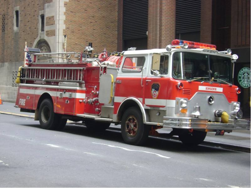

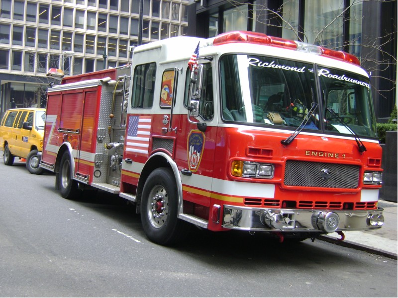

Richmond engine 1 all 3 units were staging in midtown for a movie shoot

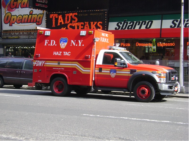

and last one a newer Haztac unit?
