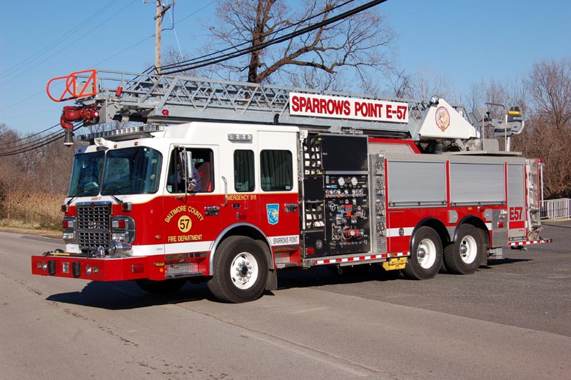

New E57 is back with a tandem rear axle and some compartment modifications.

Perhaps this has already been explained in an earlier post......if Balto. County wanted a tandem axle vehicle why didn't they spec & purchase one instead of purchasing an apparatus & having it modified.

I believe Baltimore County wanted a single axle, but the unit itself was over weight and required the additional axle.
Long story it was a big whoops when built all is well now let's hope
Wow that must have been an exspensive oops! More or less a new body and a new chassis? Anyone know what the actual GVW is of this rig now that it is on tandems?
Actually added a third axle to original body after some modifications were done. Yes a very expensive whoops. It's taller then our tiller trucks. Still a sore subject here hope it works out

Engine 57 did not get a "third axle" installed. The single rear axle was removed and a tandem axle setup was installed. A true "third axle" would be along the lines of a tag axle similar to what many dump trucks and concrete mixers are equipped with.

The vehicle now has three axles, but it did not have a "third axle" installed. That would imply that the same two axles were on it that were delivered with the vehicle, and they just put another one on it.

Looks good. Sits kinda high though. I like the seat for the ladder operator.

I understand your thinking but it's a little different then you describe.
There is a huge difference between a tandem rear axle and two (2) single rear axles. The tandem axle/suspension is a complete assembly that allows the two axles to work in conjunction with each other.
To simply add an additional axle would not work out so well.
One advantage of the tandem is that the truck now has a shorter wheelbase <img src='http://www.firepics.net/groupboards/public/style_emoticons/<#EMO_DIR#>/smile.png' class='bbc_emoticon' alt='Smile' />
