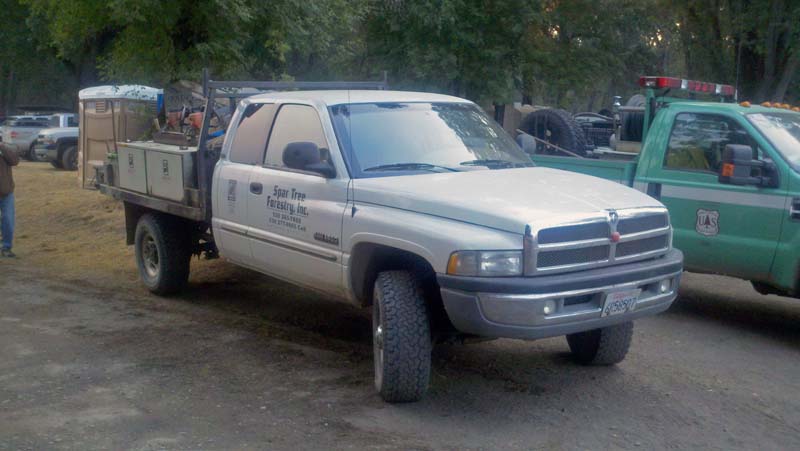

When you have really big trees it is common to bring out commercial tree felling teams. Here is a rig from Spar Tree Forestry of California.

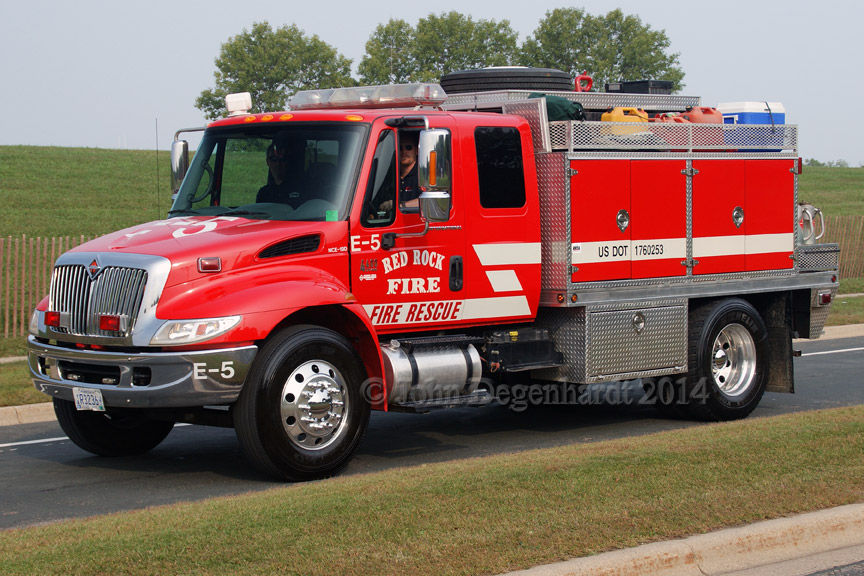

Red Rock Fire is based out of Forst Lake, MN
E-5  2003 International 4400/Tom Conway 120/1000/20   I believe this is classified as a Type 4.
E-8 is classified as a Type 3 and was built on an International 7400 chassis with fabrication done by Red Rock Fire.
2010 International CXT/RRFD  500/600/20.  From the website, the pump will put out 250GPM @250 PSI.
Based on the specs you posted, then yes, the first would be a type 4, the second a type 3.
Not familiar with the company, but nice looking trucks.
