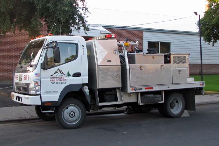

CAFS equipped type 6 engine built on a four wheel drive Mitsubishi chassis. Operated by Northwest Fire Service of Bend, OR.

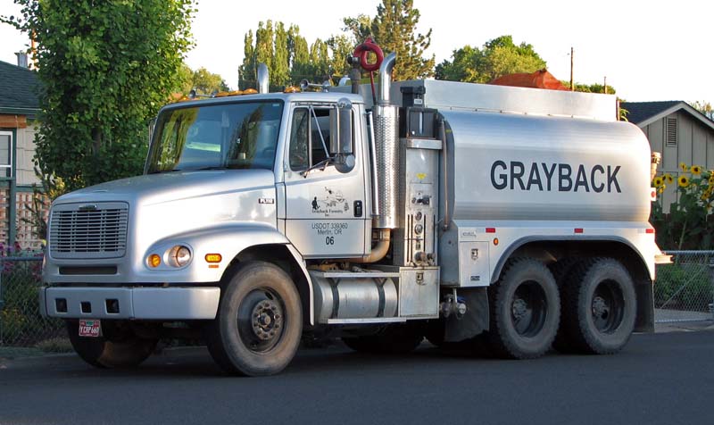

Greyback water tender

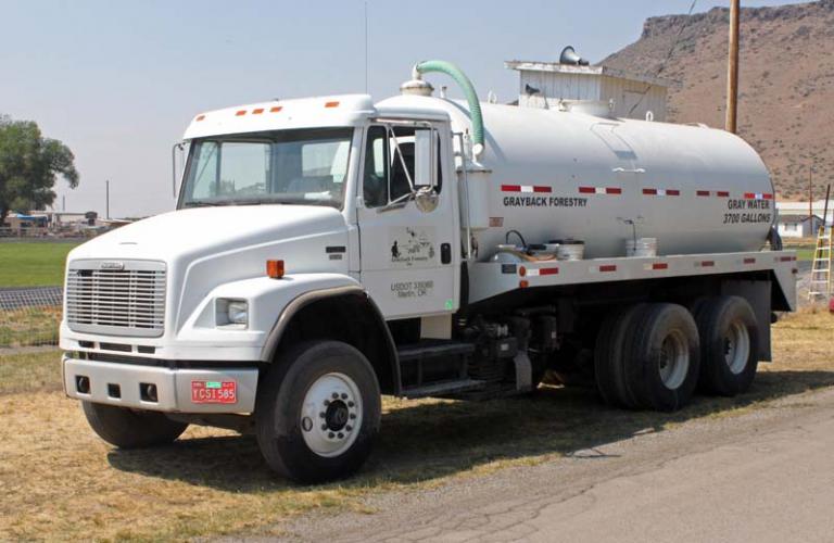

Greyback grey water tanker used for camp support

Quote:CAFS equipped type 6 engine built on a four wheel drive Mitsubishi chassis. Operated by Northwest Fire Service of Bend, OR.
This is a very unique looking truck, you wouldn't have a shot of the rear would you?
Actually I do have it from the back, here you go.
Aaron Woods
Quote:Actually I do have it from the back, here you go.
Thank you, I haven't seen many mitsubishis in use for North American fire services
I honestly would love to see more COE brush trucks in service in the states, I always hear guys saying pickup truck chassis for the shorter wheelbase but most i've seen are almost on par with a 7600 IH wheelbase which beggs the question? Arent brush trucks sopossed to be small to excess small areas? Why does it seem over the years they are as big as type 1 engine now ? Are the current COE chassis offered in the states now too underpowered for wildland work ?
