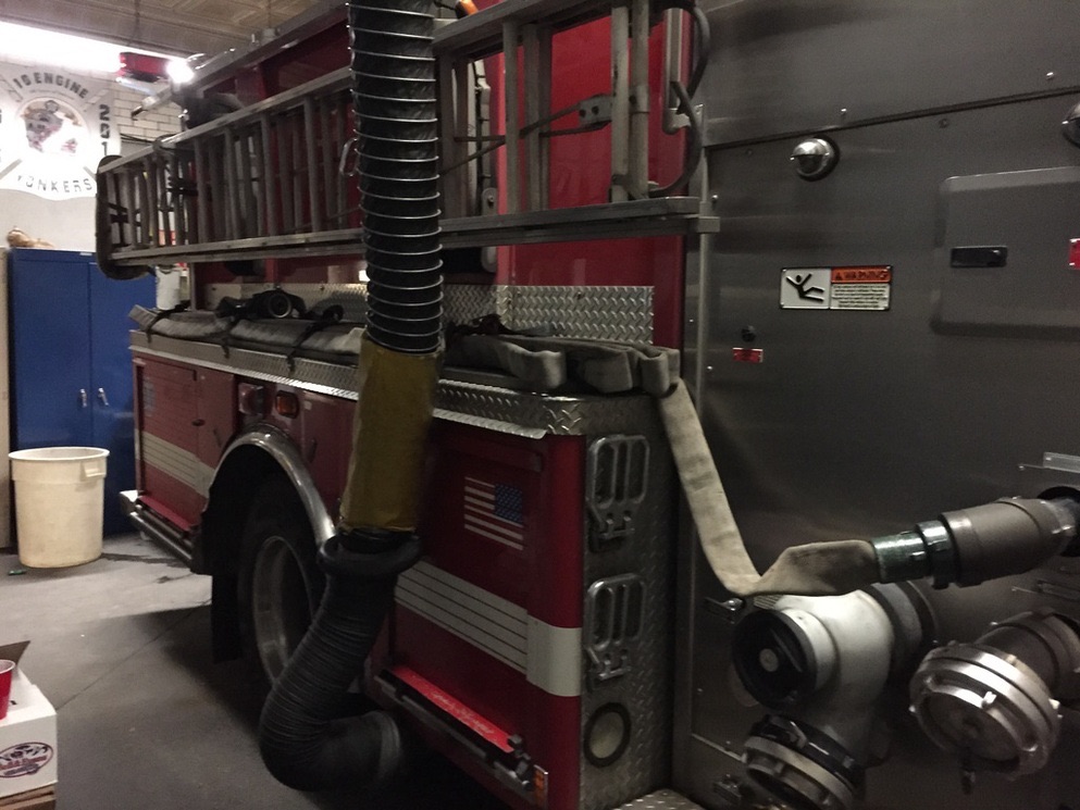

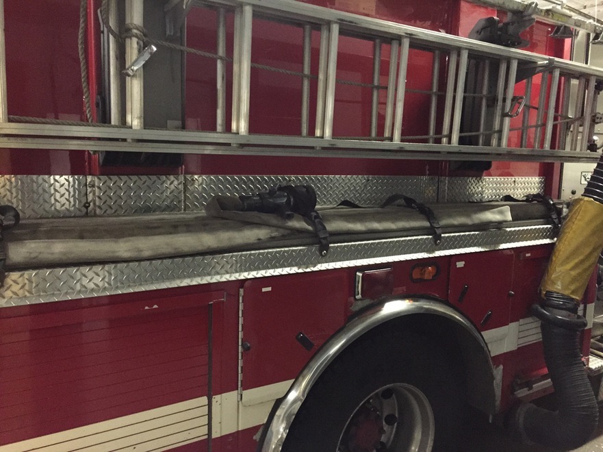

Here's the set up on an older ALF pumper. Drivers side Donuts (Roll-Ups) Hi rise.
And the 3-Lengths of 1-3/4" preconnect.
3-L
