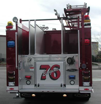

According to Larry, these have "L" shaped tanks.
What pumps are on these new rigs, Waterous or Hale? We are in the process of putting specs together for a new rescue engine and I like the compact pump panel on these units. It could save wheelbase length in the long run.
Photo from Hughes Fire Equip. web site.
LT, this photo (the same one I sent you) is a 750 L tank with the same body as Memphis' new wagons. Really makes me question them having L tanks.
I like the idea of the ZICO drop down rack on the left.
Wagonman,
Thanks for the pic. I am also curious like Barry about the depth of the hosebed. We carry 1000' of 5" with all of the butts at the front of the bed to keep the lay relatively flat and to keep the butts from having to flip in the bed. By the time you stack that to the very top of the bed, like the one pictured, we still have not really gained anything. Instead of a 2' stack of 5" 12 feet long, we would have a 4' stack 7' long with the final butt on both still being 8 or 9 feet off the ground.
