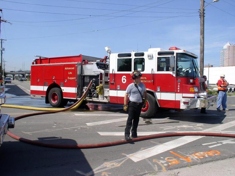

Here's an action shot of Tampa Fire Rescue Engine 6, a 1997 Quantum, one of five delivered. Most of our Quantums have two speedlay beds of 1 3/4" at 200'. Yours truly monitoring things down range while pumping a "courtyard" lay of 3'' at a natural gas leak.

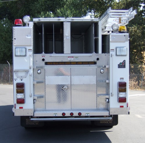

Charlotte, NC 500gal tank.
Would be interesting to see how they load the 'mail boxes.'
Smeal website photo
#87
750gal tank on an interface style wagon
Smeal website photo
