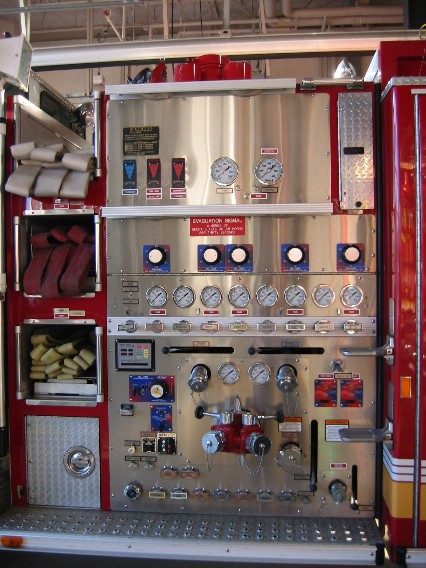

The pump panels on the ladder trucks are identical to that of the engines except the 2-1/2" crosslay is placed on top since it is rare for a ladder truck to use their attack lines, let alone the 2-1/2". They also only carry 800' of 5" supply line that is flat loaded in the bed.

A shot of the pump panel with our 3 preconnect attack lines w/ pull out drawers for repacking:
top to bottom: 250 ft of 2 1/2 inch with a combination nozzle (white) 200 ft of 2 inch with a combination nozzle (red) 200 ft of 1 3/4 inch with either a combination nozzle or solid stream depending on the group (yellow)
