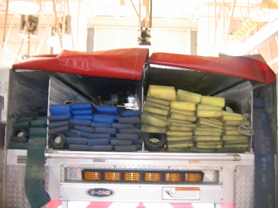

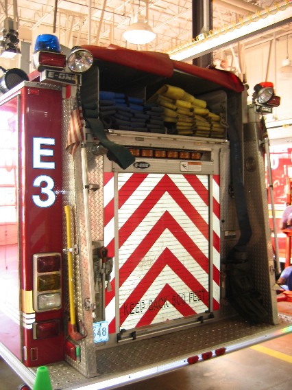

Middle River MD E - 222 L to R, 200' of 2", 200' of 1 3/4'
My photo
Middle River MD E - 222, 30' of 5" used as a soft sleeve.

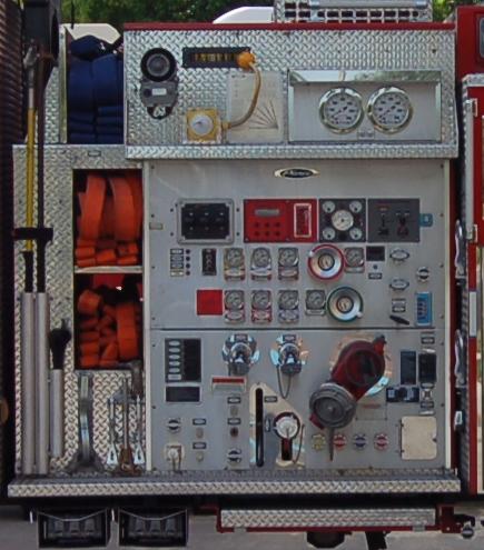

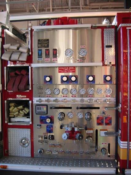

A shot of the pump panel with our 3 preconnect attack lines w/ pull out drawers for repacking:
top to bottom:
250 ft of 2 1/2 inch with a combination nozzle (white)
200 ft of 2 inch with a combination nozzle (red)
200 ft of 1 3/4 inch with either a combination nozzle or solid stream depending on the group (yellow)

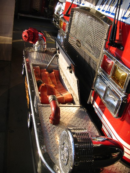

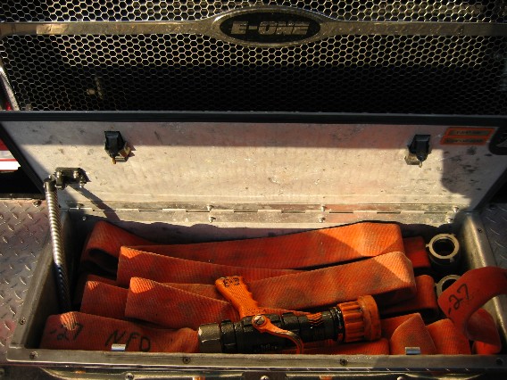

And last is the car fire/trash line in the front bumper:
100 ft of 1 3/4 inch preconnected with a combination nozzle and 50 ft of dead 1 3/4 underneath.

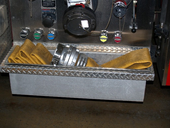

Just a side note, for our hydrant hook ups we use a hydrant assist valve on the steamer and 2 morse gates with stortz connections. That's out SOP.

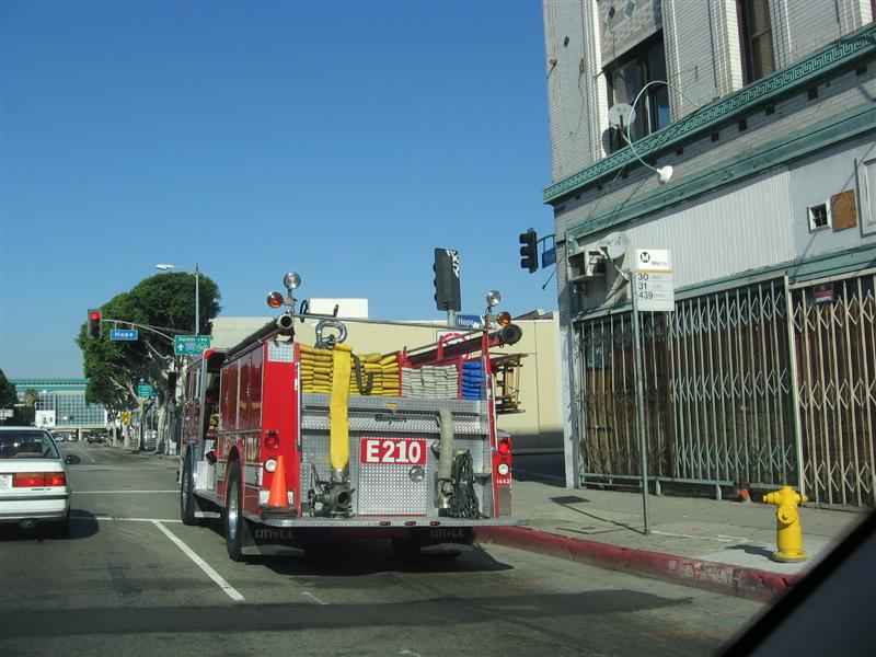

Hosebed shot of E210, the downtown companies carry their hi rise hosepacks (blue hose on the right) in the hosebed.

I'm assimin that there's two of them and they just pull them onto their shoulder like a preconnect?
[quote name='JFong' post='189594' date='Feb 16 2008, 22:11 ']Hosebed shot of E210, the downtown companies carry their hi rise hosepacks (blue hose on the right) in the hosebed.[/quote]
Doesn't look very practical.
Hence my previous question, if deployed in that manner it would be very awkward unless they have a stop in the bed. With many members it would drag on the ground, etc. Without a divider, what if the second stack falls over after pulling the first? Any L. A. people around to shed light?

The packs are stored in the hosebed as seen in the photo. When they get on scene, the packs are carried to the fire floor. Usually the hi rise packs are stored in the location or sometimes in a lower compartment.

[quote name='JFong' post='189594' date='Feb 16 2008, 23:11 ']Hosebed shot of E210, the downtown companies carry their hi rise hosepacks (blue hose on the right) in the hosebed.[/quote]
Is that an air pack on the rear step?
[quote name='ppfd' post='190258' date='Feb 19 2008, 16:41 ']Is that an air pack on the rear step?[/quote]
Yes it is
