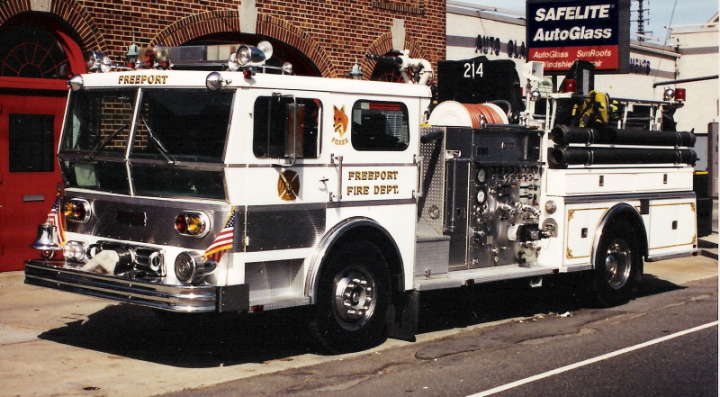

This was a REALLY fun pic to take <img src='http://www.firepics.net/groupboards/public/style_emoticons/<#EMO_DIR#>/dry.gif' class='bbc_emoticon' alt='<_<' /> ;standing in the westbound lanes of Sunrise Highway on a weekday afternoon <img src='http://www.firepics.net/groupboards/public/style_emoticons/<#EMO_DIR#>/icon_crazy.gif' class='bbc_emoticon' alt='Icon_crazy' /> , but it was worth it. One of my favorite rigs. It's not a Mack, but it's a beautiful white rig. Patriot Hose Co.4 of Freeport NY had this 1972 1250/500 for many years. can anyone tell me what replaced it, and are they still white?
