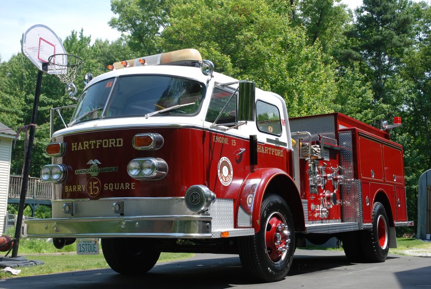

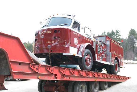

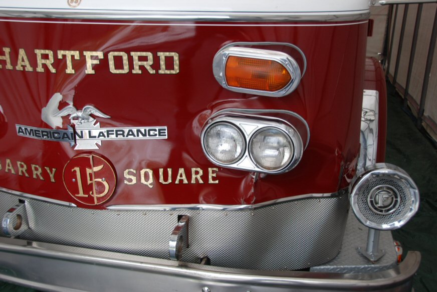

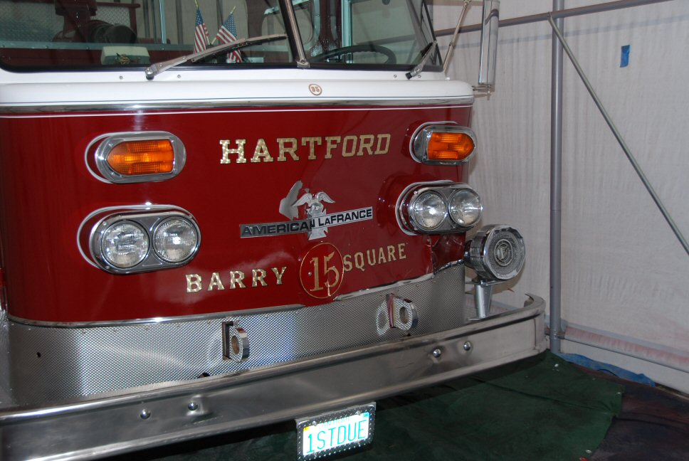

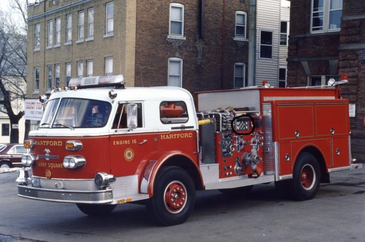

Hello! My father and I began restoring this rig in 2003. We have been near completion since about 2007. The rig was lettered by Revere Firefighter Frank Barry, and painted by my father in our back yard! Unfortunately, on December 6, 2008, it struck a deer while returning from a fundraiser. WE NEED YOUR HELP. I'd like to get this rig back to its restored state! ANY AND ALL HELP IS APPRECIATED! I have attached the pictures...but we need:
1000 Series Nose
1000 Series Lower Molding
1000 Series Bumper
Driver's Side Lower Chrome Molding
ALF Front Emblem
Left Headlight Housing
Federal Q2B Siren

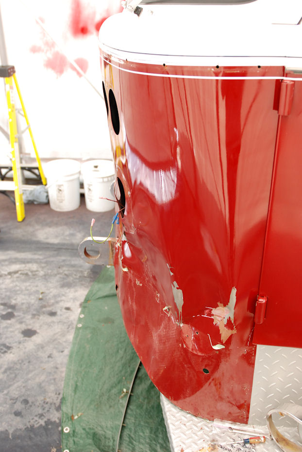

With the warm weather this weekend, I came home and stripped the nose of the truck as best as I could. Gave us a little better idea of what needs to be fixed. Take a look...

[quote name='gfdp75' post='280145' date='Feb 8 2009, 14:25 ']Hope to order parts soon[/quote]
If there isn't any damage behind the sheet metal or anything out of line, a good body shop should be able to pull the outer body skin out and try to straighten at best. You have room to work behind the outer sheetmetal. After getting the sheetmetal as smooth as possible, then they can work some body fill. Mask off the front and prime and paint. Good luck, Joel Bain BAIN172@aol.com
