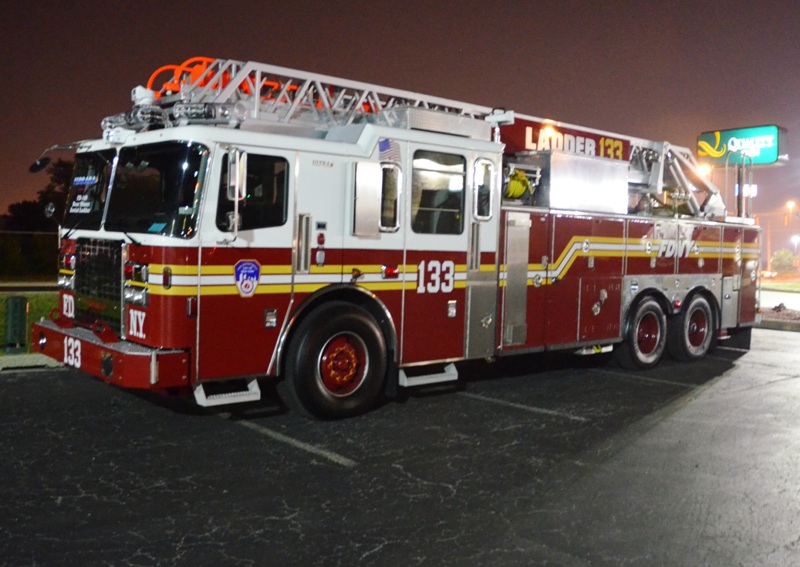

Last night while on patrol in Fort Wayne, Indiana I found 2 Demo rigs I think came from FRI. Not the best photos but you dont see a FDNY ladder in indiana very often.
2013 Ferrara 100' RM FDNY ladder 133

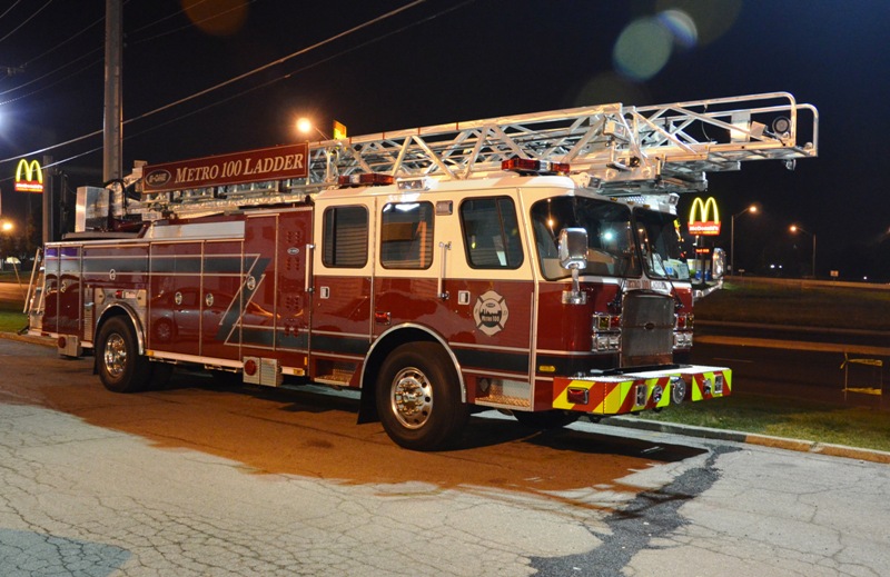

At another hotel I found this Eone single axel demo truck.

Quote:At another hotel I found this Eone single axel demo truck.
Was this at Coliseum/Goshen?
Trav!
McCormick Place

Quote:McCormick Place
The Metro I believe is sitting at Motel 6 at the Intersection of Coliseum and Goshen, it appears as if there is a Pilot sign, as well as the 2 McDonalds signs behind it. As for the FDNY Ferrara, I'm not too sure, maybe Washington Center Rd?
Trav!
Yep they dont spend much for the driver to stay i guess.
And the FDNY was on lima just north of Washington center Road
