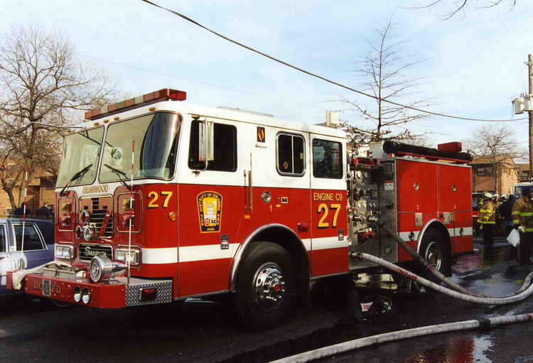

Engine 27’s 2002 Seagrave S-140.
Kevin Byrne

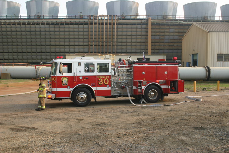

2002 Seagrave S-141 went to E-30. Photo taken on the fireground June 19, 2007
Kevin Byrne

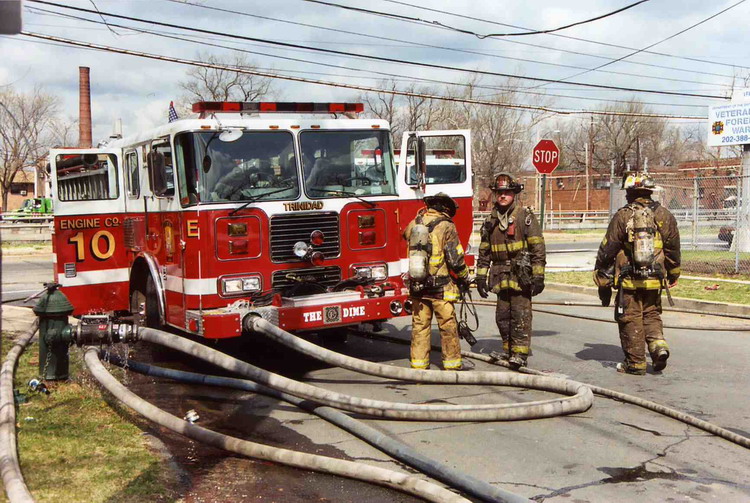

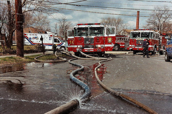

2002 Seagrave wagons of Engines 10 and 26 (S-143 and 139) on the fireground March 3, 2004
Kevin Byrne
Engine Co. 10
Kevin Byrne

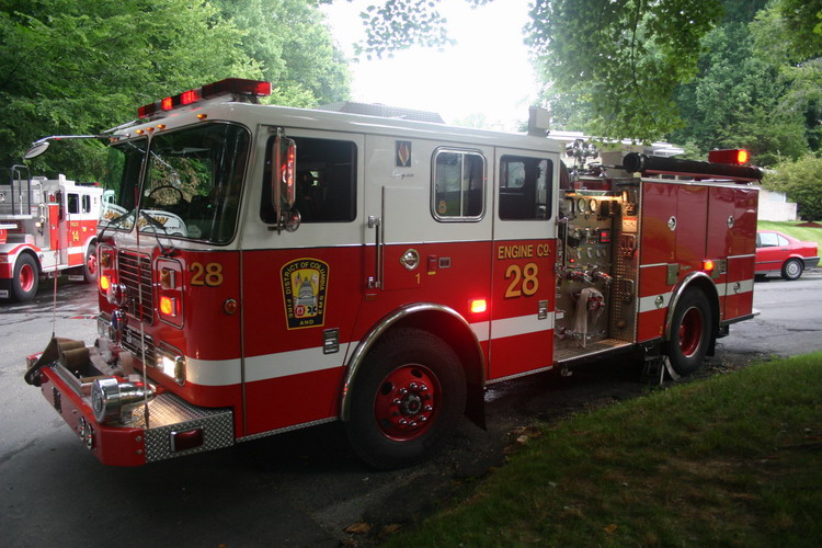

Engine Co. 15 received shop serial S-144 in 2003. It was subsequently reassigned to Engine Co. 28 in 2005. Photo taken on the fireground July 5, 2007
Kevin Byrne

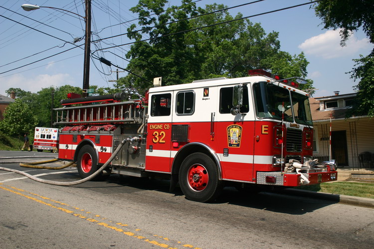

Engine 32 on the scene of a house fire at 1st St. and Xenia St. SE, May 30, 2007; the wagon is 2003 Seagrave S-145. S-145 was the final delivery on the first batch of '02-'03 Seagrave wagons.
Kevin Byrne
