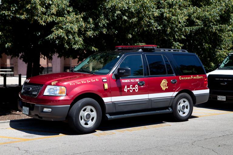

Not really sure about this one..I think it lives at the academy and is used to shuttle small groups around...first time I've seen this...
