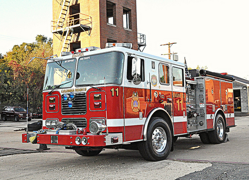

11 Engine

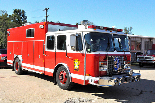

Reserve running as Rescue Squad 3
