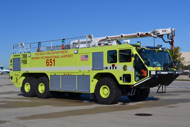

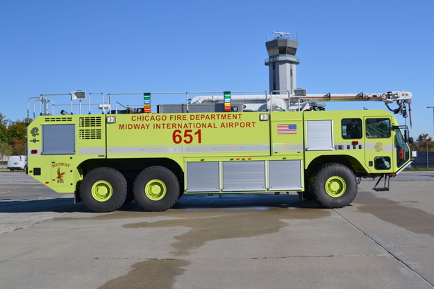

Chicago Midway Airport
6-5-1 2010 Oshkosh/Striker
1950.3000.405
Side View

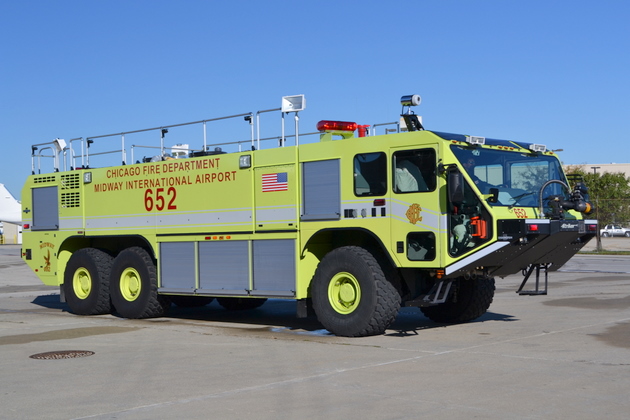

6-5-2 2006 Oshkosh/Striker
1950.3000.405
