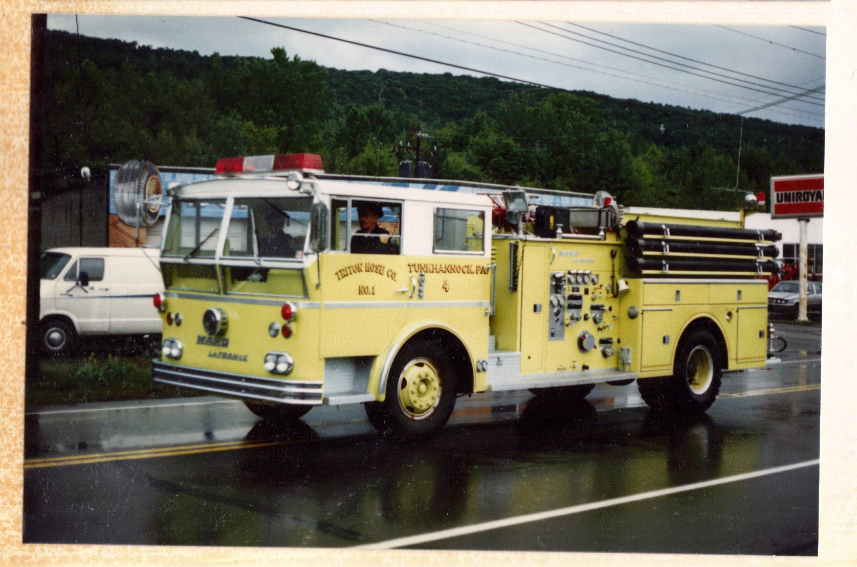

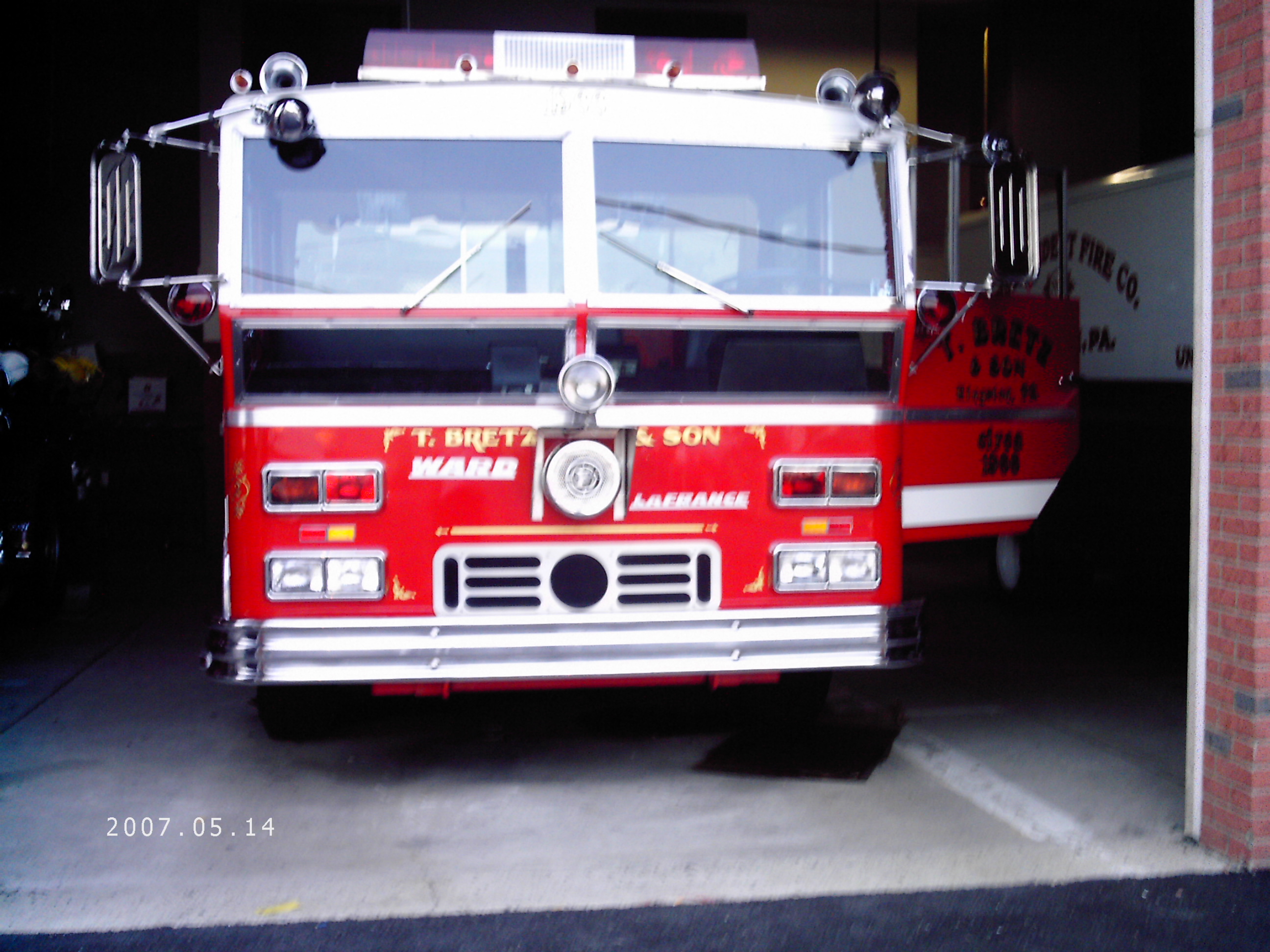

this 1966 ward lafrance originally delivered to triton hose co of tunkhannock wyoming county pa was equipped with 750gpm 750gwt gasoline waukisheau engine,standard transmission,hydraulic brakes ,manual steering.it was converted by a member of the co with 671 detroit diesel,allison automatic,air brakes,power steering.it originally served triton until 1994 when it was sold to fleetville fire co of benton twp lackawanna county pa who sent it out and had partial refurb cosmetically ,upgrading pump to 1250gpm adding 4 crosslays,preping gun.they sold it entirely stripped in 2004.it was in horrible condition with wiring having gone trhough a pair of cutters under dash,removing every piece of equipment off of it including hard tubes ,ladders,ladder brackets, & even tail lights.it had absolutely no battery boxes left to it once we got into restoring it,no jump seat floor and floor supports left on it due to rott.we didn't realize it was as bad as it was until we started going into project.thanks to a handy friend in welding and fabricating we were able to bring it back in great condition

this is pic of 66 in service in fleetville before we got it

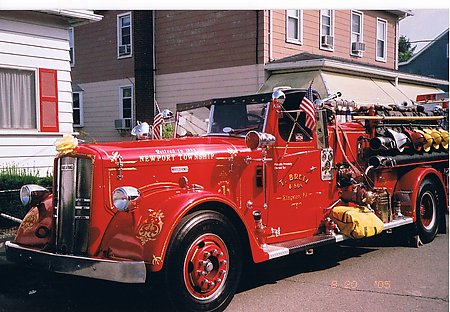

the 2 49's together at a car show in 2005
mine is on left ,ironically theres was second due this day in service

great looking ward, best of luck with it

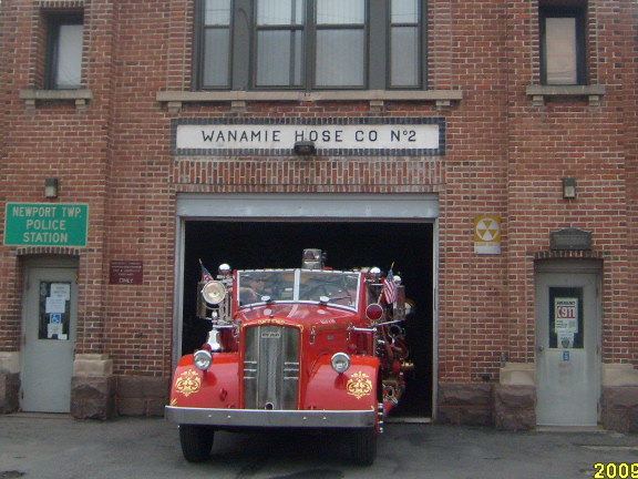

had the old girl( my 49) return to the station she served all her life here are a few pics of the visit
